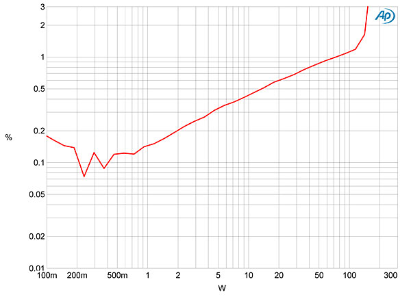

    , , . a propos , , SET push-pull. "", "". ( , , ) , , - ""- , .., . ( ) . 2 , (4 6, 8) .
    : 2 . ?? . . "". . . , , . : , . , . .
    , . "" SET "" push-pull. ? , : "", . , . "" . , "", . , , . . , , . , .
    "" push-pull "". ? , , Audio Research Reference 150:
    http://www.stereophile.com/content/a...r-measurements
    push-pull :

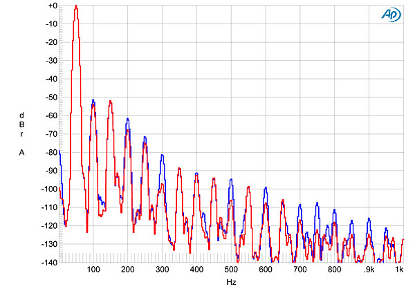

    (= ), push pull ... , (= ) . 50 Hz 37 Watt, , , . ? ( - , , , !). , . : , , , , , ( ), : ( ) . "" ""? . , . "". "", , . ? ?
  9. Default

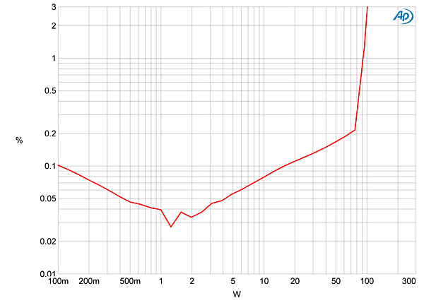

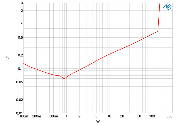

    , "" "" , , . Ceteris paribus, . Audio Research, :
    THD 1 kHz 8, 4 2 , 4 .
    4 Volt ( , ) 4 (16, 8, 4 2 ). 16 "" , (= ) . ( 100 Hz) , 200 Hz, . 8 ( ) (). , / 16 . ? 4 Volt, . , . , . 4 , () (). . 0.15% 3 . soft, , "", "" , . 2 (, ) 0.4%. 20 Volt , 10 Amperes , .
    , "" Reference 150, ( "", : , , , )?
    : 4 . 50 . , . 50 . "" - Wilson? , , ? . Sonus? Come stai? La signiora Faber? Bene? Vai via.
    : . 91, 92, 93 dB 2.8 Volt. . 105 dB, .. ( ). , compression driver. , Audio Research -? . . : hi-fi. , , , . , ? , . .
    ' : 16 . , . , . Reference 150 . 16? 12 . , 8, 8 , 7.9 .
    Audio Research Reference 150. . . Baskerville . . , - . , , : , , , , , . , , . Welcome to your life, My people.
